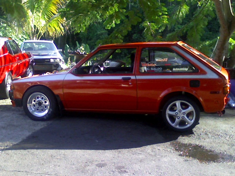

Oh yeah I got the complete engine manual for the FE3N on CD must be about 500+ pages of stuff like ECU error codes
584whp and 457 lbs of TQ.Some NOS run 10.6 @ 135mph
Stock internals but turbo FE3N in a KA 2door 323/Lazer shell
