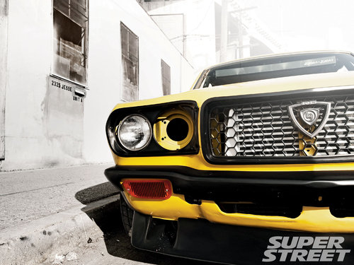

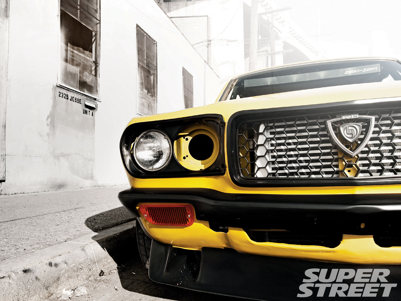

mig I see your pic and raise you this
[img]
http://www.blogcdn.com/www.autoblog.com ... rilive.jpg[/img]

nareshseep that car ulgy :wtf:
my new wallpaper
