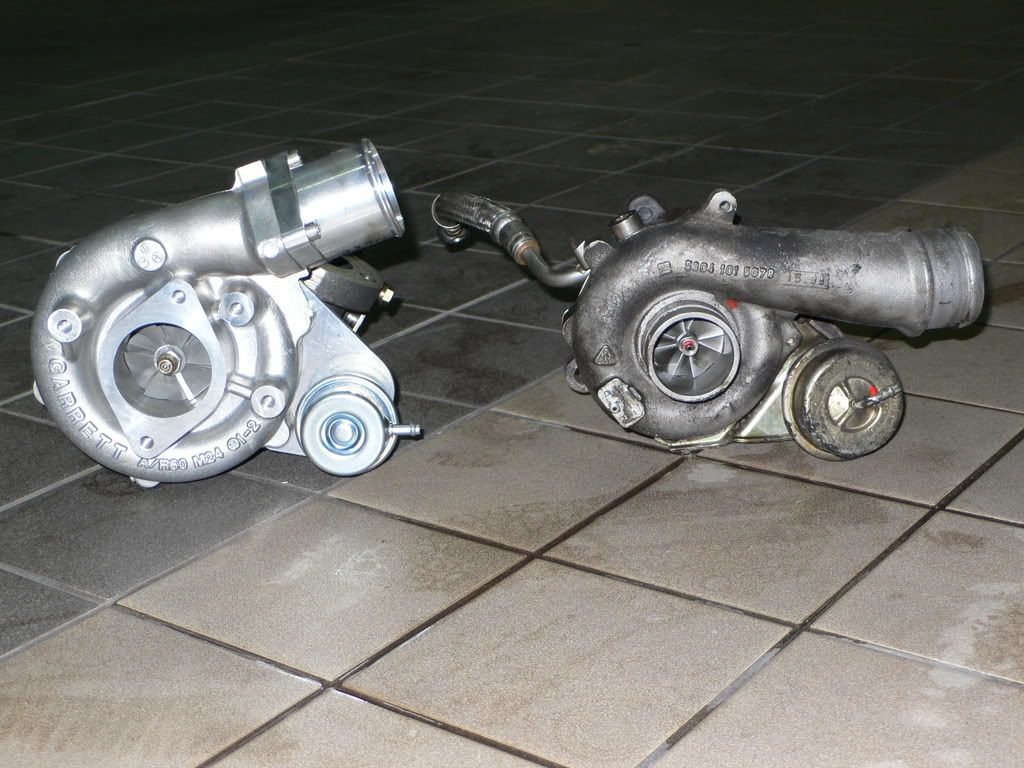

You would also find in addition to "H" sectioned rods that your 2 piece exhaust valves will require replacement if engine torque or the accompanying cylinder pressure is at a 300lbft level.
You talk about a lesser engine hitting "more than 300bhp" with a GT28RS. Well,
This picture shows what happened to a BAM code 225ps engine that was installed in a MK2 Golf and fitted with GT2871R and a DTA engine control unit. This failure occured after testing the motor to 320lbft@4800-5200. The turbo pressure was 210kPa. He soon updated the hardware to the shiny bits to the right.
This car originally had the OEM K04 but on DTA and had the same torque but occuring at 3800-4000 rpm then rapidly decreasing. To achieve that airflow the turbo was boosed to 240kPa.
ImageA GT28RS unit will produce a similar airlflow but at a higher pressure ratio and peak at a rpm point/s betweem a KO4 and 2871R assuming its the same engine.
On a 9.5: 1 engine and GT28RS you can to flow the same air but you will be limited by a lower det limit threshold and weaker engine components so even less torque pending a really good engine calibration.

Some really nice pics and info, thanks. If i'm not mistaken those look like Pauter rods and a GT2871R in a KK housing aka eliminator?
The thing is i'm not looking to go anywhere near 240kpa (aprx 24psi) i'm looking more on the lines of 18-20 psi for now with the stock internals, my main concern with going for this setup ie the eliminator is because i know it would fit with minor modifications. Also cause i'm getting a really good deal. I dont expect crazy power after all how much power do u really want in a fwd!! so i think for the money its a good deal when compared to other kits.
The good thing with a 9.5:1 compression ratio is that once the internals are strengthened, u can run much less boost and make the same hp than on a low compression motor running more boost. This can significantly improve engine life.

Postby thegtiman » June 14th, 2008, 4:43 pm
TriniVdub wrote:The good thing with a 9.5:1 compression ratio is that once the internals are strengthened, u can run much less boost and make the same hp than on a low compression motor running more boost. This can significantly improve engine life.
Not really as your detonation threshold is lowered so your torque per rpm reduces at full load. This is one of ohe reasons for lowering static compression. With the 9.5:1 engine (AGU) your dynamic compression is less too as the cam combination are not as aggressive as the high powered vesions.
How much "power" in a FWD? Lots currently finishing a ABV 2.9 VR6 T.
240kPa = 20psi
210kPa = 15.9psi.
The turbo is from a ATP GT2871 eliminator kit.
The OEM rods were updated to Pauter jobs after failure.

GT28RS - improved spread of air flow into higher rpm ranges of the engine, which means increased need for more accurate Mass Air Flow mesurements or MAF to Voltage ECU calibration.
KM manifold - increased energy distribution to turbine nozzle. Reduction in exhaust reversion
415cc injectors - more fuel flow to hit target AFRs for optimum torque with increased air mass at higher rpm. Hopefully in mutispray pattern
* need to make sure your fuel pump is able to meet increased fuel demand*
2.75-3" downpipe for the first 50cm.
Turbo Intake Pipe- Intake pipe needs to match turbo compressor inlet and is larger than OEM (see picture in previous thread)
Unitronic - I am not into flie flashing or downloading unless I know what is done to the calibration and have validatated myself so cannot say.
EBC - a 1.8T engine will come with a "N75" valve and is ECU controlled something that should be included in the ecu calibration.
Running on OEM internals - to optimise is subject to custom tuning on a dyno or other validation device and including road tuning. Updating to another file in this case may work but is not ideal for optimisation neither can anybody ensure that your engine will not grenade except the Unitronic supplier.
