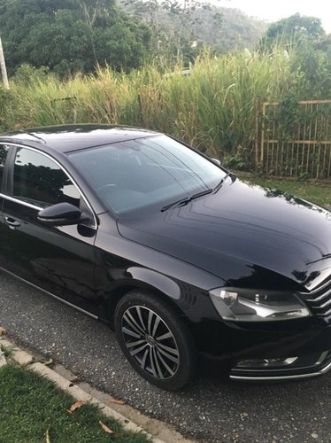

Postby jhonnieblue » January 25th, 2016, 6:18 pm
Well she is back home safe and sound
Now just to sort out the oil problem
Think the engine need a rebuild..taking oil every 500-700km a quart
Think bess auto will give goodwill?
Now on 105,000km
