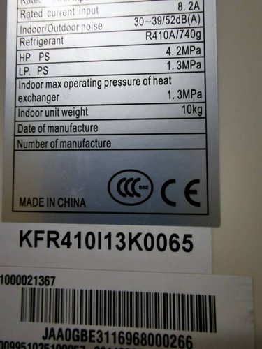

I have a Lennox 18000BTU inverter unit and every so often the unit blows hot and shows an error code "H5" or "HS" (not sure based on how the digital readout shows characters).
I have to cut all power to the unit for about five minutes and then switch it back on and then it functions normally. This problem occurs at least once a week.
Can anyone shed light on what could be the problem before I call in a technician to look at it?
Thanks.

I forgot to mention that I already checked the manual that I have for the unit and that document had the same error codes that the document in the link that maj. tom posted above had.
There was no H5 error code in either document, hence my query.
