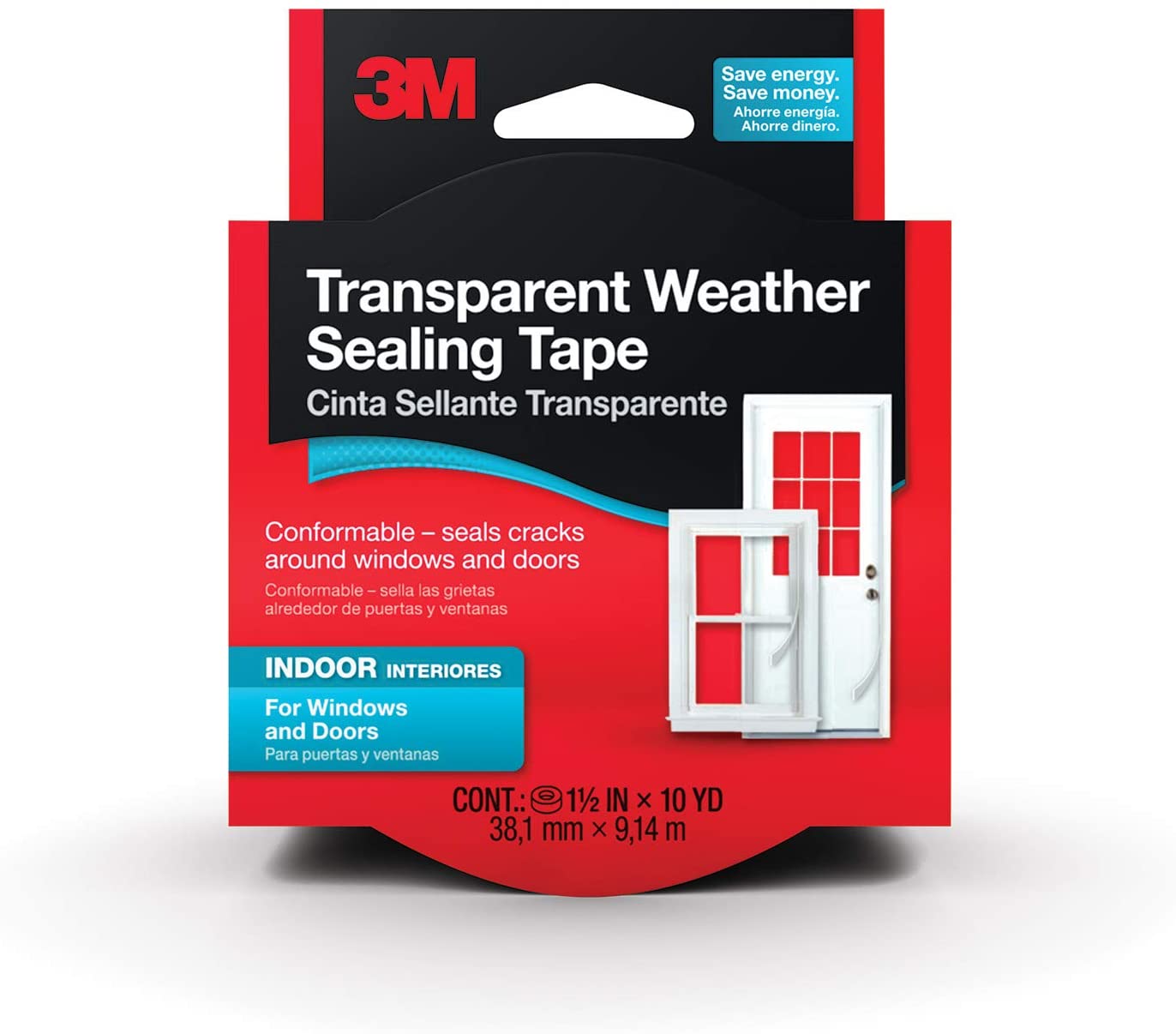

This seems like a good place to ask...
Anyone know where I can find this? The tape will be making contact with the iron window frame, some glass and the concrete wall. It has to be able to withstand a LOT of heat and not get brittle and fall off soon after. Purpose is to keep air from rushing in through all the gaps in the window frame.
If this can't work, will appreciate any recommendations and where to source. Thanks!
https://www.amazon.com/3M-Interior-Tran ... CBIFF?th=1

Is the air rushing in between the window frame and the masonry window pocket/opening?
What is the size of the gap you are attempting to seal?
Soul Collector
Posts: 2231
Re: Building a house in Trinidad
Postby Soul Collector » January 7th, 2022, 10:24 pm
carluva wrote:Is the air rushing in between the window frame and the masonry window pocket/opening?
The air is coming mainly from gaps in the window frame itself after taking another look. Once the frame is closed, there are gaps of 1/4" or less vertically (where iron window frame meets main iron housing) and smaller gaps on the underneath/top of the frame.
There's no space between any of the masonry work, just that the frames don't fit very tightly or snug once closed. The curtains are always blowing as if windows are opened when a strong breeze passes, lol
