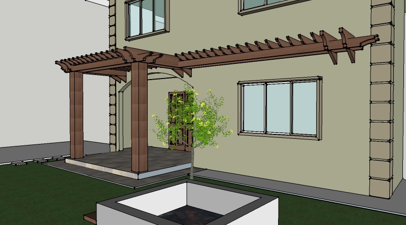

I am looking to build a pergola as shown in the picture below. what is the best type of wood to use that would not rot, get termite,and last for quite a while.
Additionally is there a substitute material i can use ?

greenheart or purpleheart.

Mora should last about 10-15 years or so.

they supplied (and installed) the greenheart for some wood flooring. greenheart, teak, and other hard woods are naturally termite resistant, but for external you'll need to use a sealer. there's no external and internal wood per se.
i plan to check them again to do some outdoor wooden decking and a pergola as well.

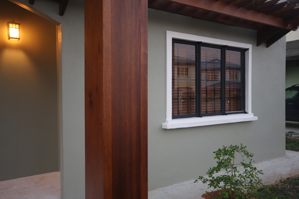

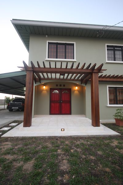

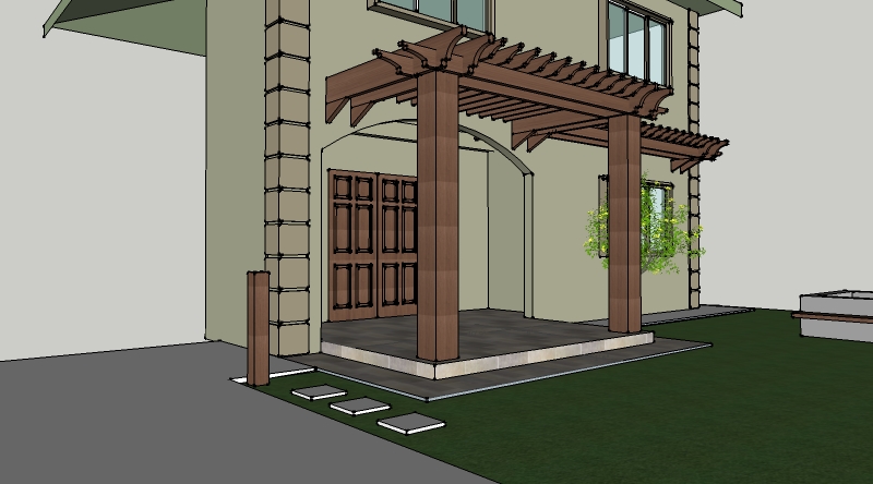

I built one using greenheart
Paul 684-5350
This is what I did in Google SketchUp
this is the final product (waiting for the grass and plants to grow)
will check unique doors cause I really want to change the front door and get rid of the burglar proofing.

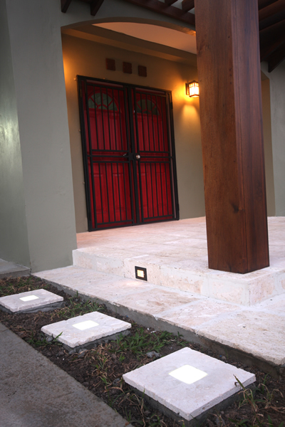

^ the limestone coral (tiles) I got from Rafmon Marketing, SeaLots http://www.rafmon.com
the lights for the pavers are LED brick lights that I got at Nova Lighting in Woodbrook http://nova.hadcoltd.com
I cut a square hole in the middle of the tiles to fit the brick lights and then I set then in concrete to make the pavers. When the paver lights are off its hard to tell thereis a light there as its very similar to the limestone coral.

Both green-heart and purple-heart are available locally , use you phone book and call a sawmill , for a base for a raised tank, purple-heart lasted unsealed for 30 years, the new application use purple-heart again , coated three times with valspar sealer , some notes:
this wood is very hard , i used a hacksaw and yeah, although very hard it can splinter easily if not cut or worked right,
the valaspar brought out a deep red in the wood very attractive, but also very slippery

(...Rovin...), the greenheart is pre-treated lumber and then coated with a spar urethane deck sealant (I used Helmsman MinWax Spar Urethane)
green heart and purple heart are used on jetties and last years
In the US they call them Brazillian Hard Wood and it's considerably cheaper here than in the US as we can import it from Guyana

I would highly advise that everyone download Google SketchUp (I am sure you will find it very useful to design speaker boxes) - its free software and when you draw your idea you can give it to the joiner or contractor and you end up with exactly what you want - no guess work and misinterpretation
plus you get to see what it looks like before and there will be no unwanted surprises.

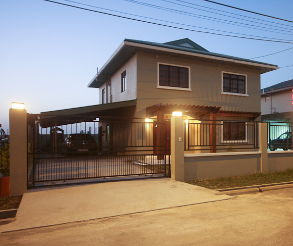

I just realised that when I took the pics I hadn't installed the pendant light that now hangs in the middle of the pergola, its just a pendant version to the sconce
a lil pre-planning for the electrical and getting the right materials made alot of difference

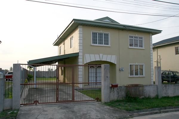

this was the house before I got it
this was after a lil dedication, hard work and planning
