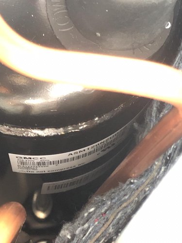

Postby nervewrecker » September 22nd, 2020, 10:22 pm
wisnow ac compressor.
disclaimer: not affiliated with the brand in any way although the dealer and myself have the same name.
