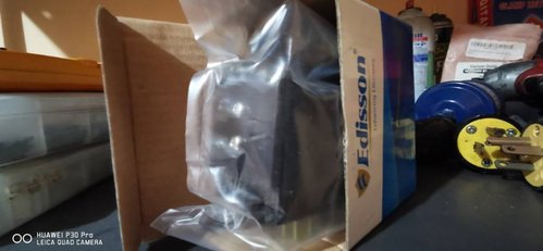

And wrt question on contactors in classified environments, see pics.
Brand new Edison double pole in pic in plastic with cover on also shown.
The other two are parts.
