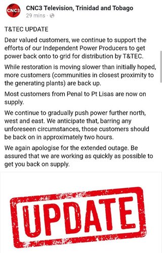

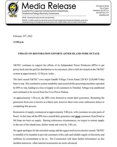

Postby Cooper » February 16th, 2022, 10:26 pm
From Cnc3 Facebook page

pugboy wrote:so countries with many sources of power eg europe with many many wind farms all over the place, they suffer these same issues ?
No Pug
Power generation is different.
In this case, the Penal plant took down the rest of the plants. All plants are on the grid. When a plant does down, the other plants try to pump out the Megawatts to make up for the loss. In this case, the load was too demanding and thus a trip to protect the generators. load demand was too high and not enough redundancy to make up for it. All this happens in the blink of an eye.
This happens from time to time and its not new. Its a balancing act. Power demand controllers are use but even those fail.
Within each plant there are a number of generators and all those that are put online need to maintain the same frequency. You can't have frequency not matching, it will be a trip if out of phase.

An important point to note is that electricity isn't produced and stored like say water. Electricity required is generated at that instant.
So as you explained, when one producer goes down and the demand remains the same, the other plants pick up that slack and that could put serious strain on the infrastructure.
Practical Engineering on YouTube posted an excellent video breaking down the 2003 US blackout.

Cid wrote:Just got some legit intel............ situation at TTEC Ghandi village substation which dropped the frequency resulting in all plants going down....
Legit indeed!
