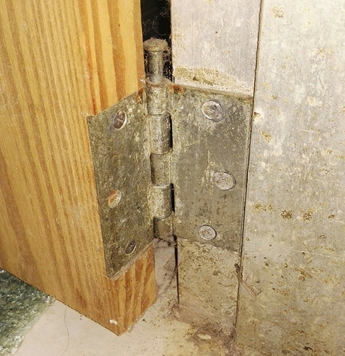

Can anyone advise how to repair/replace the door hinges on an aluminum door frame. The hinges are riveted into the frame and on the bottom hinge, the rivets are now slack. The door now needs to be raised to properly close. Thanks.
Posts: 9325
Re: Building a house in Trinidad
Postby *KRONIK* » June 6th, 2020, 5:26 pm
Drill out the rivets and use a bigger size when replacing
h1tach1 wrote:Can anyone advise how to repair/replace the door hinges on an aluminum door frame. The hinges are riveted into the frame and on the bottom hinge, the rivets are now slack. The door now needs to be raised to properly close. Thanks.
Postby adnj » June 6th, 2020, 5:32 pm
You need:
Electric drill
Masonry drill bits
Metal drill bits
Pop rivets
Rivet gun
You may be able to repair without removing the door.
Use a drill that is smaller than rivet diameter and drill out the rivet center. Using pliers, remove the rivet.
Repeat for all rivets. If there is mortar behind the frame, use a masonry bit of the same diameter as the replacement poprivet to clear a space about 1/4" more than the rivet insert depth.
Install the pop rivet with a rivet gun.
Postby rspann » June 6th, 2020, 6:27 pm
If it’s the type with screw and nuts , and they run slack , you can just cut away the plaster in the area of the hinge and re-tighten them . Add a lock washer to prevent it happening again . Refill the hole and you good to go .

Postby h1tach1 » June 6th, 2020, 7:29 pm
Thanks guys. (see hinge below)
