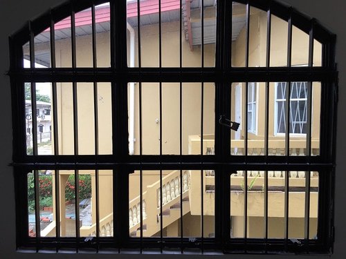

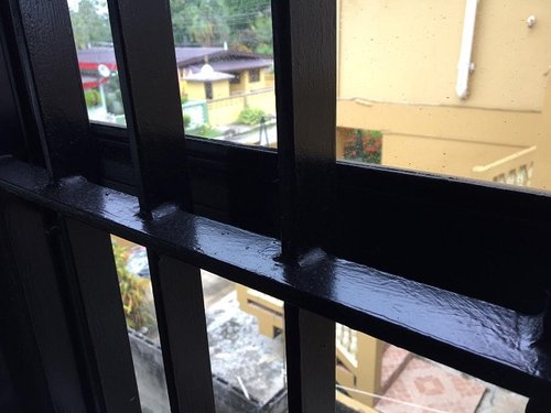

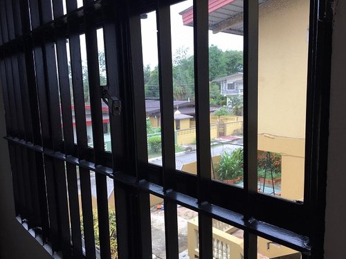

nun fancy, just plenty wukk to notch the flats so they would slot together
I need to relocate the padlock tho. I didn't specify the spot. I'll probably weld some rings so I can just slide a bar along the full width of the window

those are 3/8” flat ?
once they welded good so nobody can put a crescent wrench on the flat and wring them out
padlock really looking terrible there

pugboy wrote:those are 3/8” flat ?
yeah 3/8
Those things ain't moving for shyt, not even if you try a car jack
Welds have good penetration, and they interlocked, so I can't see anyone wringing those out
But no matter what you have, they will find a way. The idea really is a deterrent / something to slow them down

the common windows made with flat bars are the easiest to break with a wrench
a padna got broken into so
i ended up adding round bars to my windows to reduce chance of using a wrench.

pugboy wrote:the common windows made with flat bars are the easiest to break with a wrench
that's why I went with the 3/8 x 1 1/2 flats. THose are insanely strong, especially with the spacing of the horizontals limiting leverage. Even if you pry two of them apart, you need a reaaaaaaal maga chile to squeeze thru
The verticals are spaced about 4" apart so you not even getting 2 inches belly on either side, unless you have something with enough force to break the welds
Plus the verticals are slotted into the horizontals, so they can't slide along the horizontals even if you manage to break the welds
