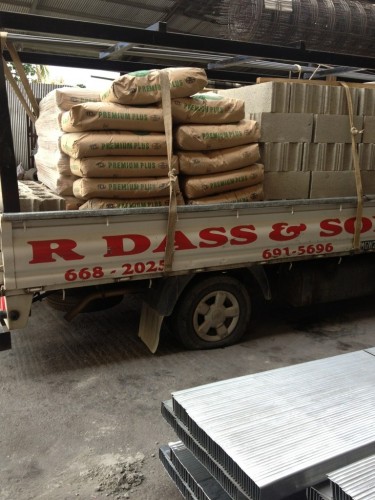

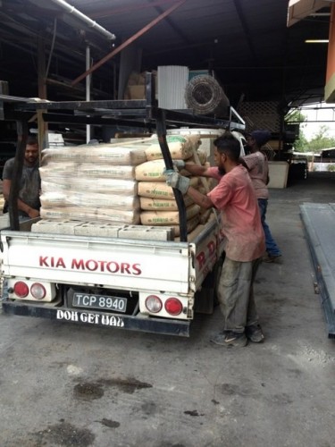

HaRdCoRe_YoUtH wrote:Kia is a great buy. The one with the double wheel to the rear. I personally own one and it works like a mule everyday. It has been put to the test so many times and it have proven itself. I have never had any issues with mine thus far but parts can be sourced at A1.
The attachment ImageUploadedByTriniTuner1376960942.678731.jpg is no longer available
Took this load to matelot no problem. 250 foundation blocks 50 cement steel etc!!!
Hope this helps
Pallie,that picture shows one pallet of cement,one pallet of blocks,a pallet of cement carrys 35,pallet of blocks is 150,where is the rest?according to your info,that is.
Pal! Really doubting me? Why lie and give false information!! Cement packed to the side! Blocks were packed to the back and sides!
Don't really like people saying that I lied!!
Let me know what you have to say now!

HaRdCoRe_YoUtH wrote:Took this load to matelot no problem. 250 foundation blocks 50 cement steel etc!!!
250 foundation blocks (8" x8" x 16") @ 17.5kg/block = 4 375kg
50 sacks of cement @ 42.5kg/sack = 2 125kg
Total load = 6 500kg
And I did not even check the welded wire mesh reinforcement.
What's the load carrying capacity of the K2700 again? Not around 1 500kg? Somebody correct me please! I can't believe this man overload the van by a factor of 4.33 and then thought it safe to drive on the nation's roads.
Hope this helps
Back and sides my a$$,all I am seeing is some blocks on the back,cement on the sides,plus blocks still can't make up a hundred,anyway the tray on that van is 10 x5 feet,you cannot pack another hundred blocks there,because the two pallets took up most of the tray space,looks like some blocks missing on the front pallet also,did not say you lied,but I would like to really see that van accomplish that feat to matelot though.
When that van is loaded,the mud guards does drag,plus with that load chances are the tyres could blow away,but guy says I am calling him a liar,would really like to see that feat he says he pulled though.I know for a fact the tail pipe does rattle,because it is between the chassis and lift spring with that kind of load,BUT,I know a guy who had a older model where he changed the leaf springs,that fcuker put up a hundred bags of cement on that van,I saw it my self, plus other things on the rack,took it to Tobago from south eh,just not seeing the quantity of blocks he is speaking off.
