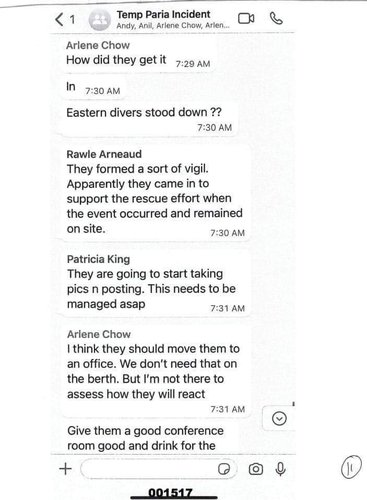

so it’s pretty much confirmed they were alive for a looong time whilst paria blocked rescue efforts
so what is gonna be the end result of this coe?

The next series of messages are time stamped at 7.29 am.
Chow writes, “How did they get it,” then “In” then “Eastern Divers stood down??”
Arneaud responds, “They formed a sort of vigil. Apparently, they came in to support the rescue effort when the event occurred and remained onsite.”
King responds, “They are going to start taking pics n posting. This needs to be managed asap.”
Chow then chimes in again, suggesting the group, who remain unidentified, be moved to an office.
“Give them a good conference room good *sic and drink for the,” Chow’s next message reads.
