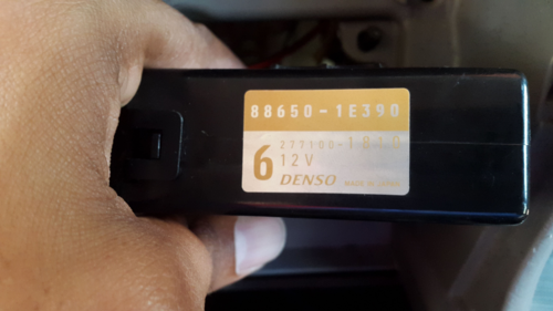

Nerve i hijacking allyuh ched lil bit, but it still ac related...help meh find this part please nuh...plenty "ac" men watching me like wtf i talking about...

shake d livin wake d dead wrote:Nerve i hijacking allyuh ched lil bit, but it still ac related...help meh find this part please nuh...plenty "ac" men watching me like wtf i talking about...
looks like you might have to skybox that one in.
Re: Air condition Service
Postby rspann » October 5th, 2019, 9:47 pm
A/C ampliefier for which Toyota, year and model?

rspann wrote:A/C ampliefier for which Toyota, year and model?
Nze 121
2001
