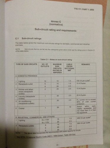

Postby demented » April 30th, 2014, 8:18 pm

Postby nervewrecker » April 30th, 2014, 8:26 pm
The man with the hook up already post in here you know.

if your panel is short of space you can get breakers which are two single pole in one to free up the space taken by 110v single breakers
but you still need to make sure the panel is balanced loadwise
btw it is best practice to run also run a separate breaker box at the unit location which the a/c guy connects his wires to so it can be switched off with the breaker there if need be, this way he does not have to mess with main panel
normally use one of those little weatherproof boxes which takes 2 breakers in it

nervewrecker wrote:The man with the hook up already post in here you know.
that guy gave some OK advice it is up to OP to deal with it the proper way
As I said before up get what you pay for

Postby demented » May 1st, 2014, 7:30 am
^^ ok. thanks.
The A/C specs there was for 110v (20A) window units though.

4mm for 110 plugs in a house or a huge building? Sounds like eil just wants you to use bigger more expensive cable.

Postby devsingh » May 1st, 2014, 11:54 pm
12,000 Btu split unit single phase uses 6A
the unit comes with a 20A tandem male plug
therefore the female of that plug is also rated 20A
the rating of the breaker should never exceed the current carrying capacity of any of the components.
the wire rating of 2.5mm is 25A- more than sufficient
an isolator/ switch or removable plug outlet should be a distance no greater than 1.3m from the appliance.
Please get a licensed electrician to handle this
and don't forget to update the schedule on the panel
