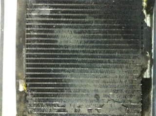

This is what your evaporator looks like dirty.
Dirty vs Clean
We have never seen a product that can clean the evaporator PROPERLY without removal. It might only touch the surface a little bit.
Cabin air filters are very important to replace when they are finished doing their job. They are not made to wash & re-install.
A dirty evaporator needs to be removed, cleaned through the cores & replaced.

agreed. the best way is the remove and clean. many vehicles dont come with the filter though, hence the reason evaporators get so dirty. i am just afraid of touching a dirty evaporator. in my experiece they tend to leak after a while.

Product Review: Valvoline A/c Evaporator cleaner/deodoriser
Postby King Kool » April 13th, 2012, 1:06 am
The pic shows a Tiida evaporator core, not an old car if that is what you are referring to. Getting to the evap to clean from the blower will be a better job but still you need to understand that these evaporators are about 4" thick. The amount of dirt that is stuck in the core, any other method is a waste at our standards. After all, our customers pay for a proper job not DIY. We remove the evap off the vehicle & use a pressure washer along with cleaning chemicals to get rid of all the accumulation. If you should see with your own eyes the cleaning process & the quantity of pollutants that accumulates & washes off maybe you'll understand that although with your DIY process it may seem as if the evap gets cleaned but that is probably only 1/4 of it. Think...what about the ducting behind the evap???? You can't even reach that. At the end it is what you are comfortable with & what your mind perceives as.....well....clean!

yup, i understand that. removal is a good option. at the end of the day, the valvoline product is probably a good option for maintenance of the evap. an a/c that needs hardcore cleaning needs to be scrapped
