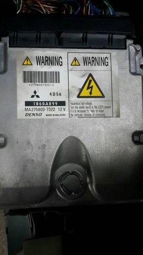

Looking for a ecu for a kb4t sportero like this one in the pic 7846278
