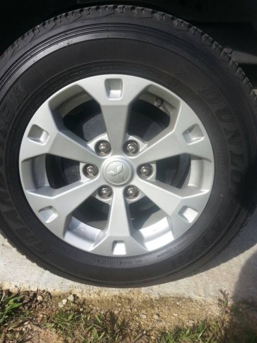

Hey guys! I'm looking for a little advice here. I have a 2012 Sportero with the 17 rims like the one in the pic. The original tyre is Dunlop and the size is 245 65 17 but I want something wider. I'm not an off roader just a daily road driver. So my preference in tyre will be one that can handle wet/dry conditions best. What brand of tyre is good for my application and how wide can I go on those stock rims.

265 should take it easy and without probs
what biand for street driving is totally up to your pocket
you van get shi-t Roadstone for ~$800 Ea, great Michelins for ~$2200 Ea or a lot of other brands in between those prices

I have those 17s as well.....I put Bridgestone duelers 265/65....I felt a little difference at high speeds...ie.....took a lil while longer to reach 180km/h......but was told it shud last almost twice as long as the grandtreks u have in d pic which i got d van with also ie. shud last over 80000km....I saw them last about 70000 on a fren hilux....very slight extra feedback in steering as well, tried speed balancing a few times but never went away. tolerable though. Got em at ramrattans for 5400 for d set which included balancing and nitrogen

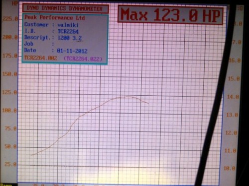

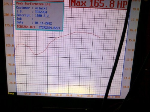

i have two questions about this as i was thinking bout buying myself
what is the performance like using the tuning module?
and secondly for the boost controller, you are setting the boost? is that wise to play around with?
Val
Posts: 2469
Re: TECH Thread - MITSUBISHI L200, Sportero, Triton.
Postby Val » January 18th, 2014, 11:04 am
The van was tuned on a dyno, and boost beyond 20 psig will trip the overboost failsafe on the stock ecu.
So you have protection on the van already from overboost, and the boost controller itself has overboost protection (I had it set to 19 psig).
