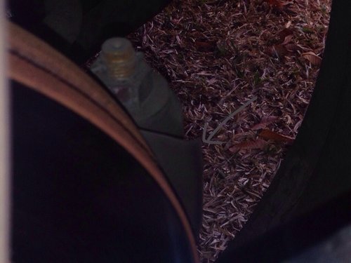

This is a part of my brake system that seems to have slipped forward from my brake pads, van was serviced just 5 weeks ago but I now noticed this and I can't say whether it was immediately after the service or gradually but I have to go sort it out tomorrow , it's hard to take a pick between the spokes of the rims but can anyone surely identify it.who says that you need properly functioning brakes
The grey arrow is pointing to the abnormality
lighthammer
Posts: 4519
Re: Tech Thread - Nissan Frontier, Navara, Pathfinder.
Postby lighthammer » March 19th, 2014, 1:53 am
looks like either your shield for the rotor is bent.
Easy fix, just bend it back with ur hand or whack it with a hammer.
