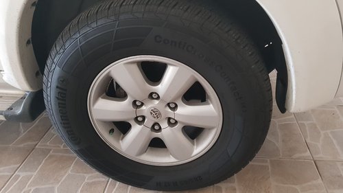

pinkz wrote:Buddy i have 275/65r17 on my stock 2010 hilux an it does touch when i lock all..so you mite get some problems with such a bigger size
trebornattaj wrote:Not sure if this was answered, can I use 285 70 17 on a 2010 TCS 4x4 hilux 2.5? I'd appreciate and answer asap please, getting a set to buy but want to know first, thanks in advance tuners
Folks I have a TCT 2011 Hilux with 285/65/17 tires. they DO NOT TOUCH.
Tires: Continental Cross Contact II
Thats just 1” over stock
You can get away with that depending on the wheel offset
I notice you have no mudguard

PariaMan wrote:
Correct. Van did not come with front mud guards.
Posts: 9323
Re: Tech Thread - Toyota Hilux...D4D and all older models.
Postby *KRONIK* » April 5th, 2019, 7:30 am
Yea
You would have gotten touching issues if you had them installed.
I running 285/60/18 currentlt with a 2”lift and i still getting some touching, but it so slight, i cant find the spot.
I had to do a lot of heating & reshaping of the fender shields and flares and mudguard to run that size

SHarripersad wrote:Kun26r-prpsy rotor warp. Toyota grinds and a few months later it warps, so it gets replaced under warranty. Replacment warped, I got it grinded and its a matter of time before it warps again. There is a hot cold explanation for this, but for decades of driving, I. Never had this issue on Ford and Nissan vehicles. Can anyone guide?
So I replaced the rotors with aftermarket debe 600 a pair, my
Partner got them 40k already without warp issues thus far so I went on his word and got a new set for mines
Also change the brakes to hi-q 400 for the set. Hope it can last like or near the original
