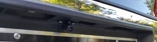

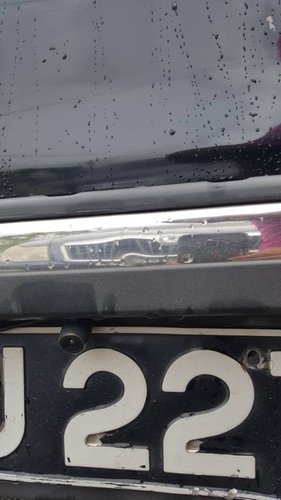

There is an issue with camera mounted by the bumper and number plate area. Gets dirty and vision gets blurred quickly. Get the type that mounts on the back tail gate
PariaMan
Posts: 3744
Re: Tech Thread - Toyota Hilux...D4D and all older models.
Postby PariaMan » August 11th, 2019, 9:07 pm
i have my own mounted just above the number plate, its really protected by the bumper over hang and stays clean
mitch1980
Posts: 827
Postby mitch1980 » August 12th, 2019, 1:58 pm
SHarripersad wrote:There is an issue with camera mounted by the bumper and number plate area. Gets dirty and vision gets blurred quickly. Get the type that mounts on the back tail gate
so in my previous Hilux I had the camera mounted on the number plate and even though it worked well the view is limited to lower levels.
when I changed Hilux I got a camera mounted on the Tail Gate which gave a 170 degree angle view as well showing objects I missed with the number plate mounted camera.
the Tailgate mounted camera also get dirty but not as much the one mounted on the number plate.
