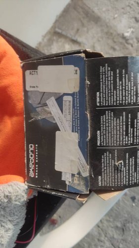

Postby X_Factor » October 11th, 2021, 8:17 pm
Got these recently
CD4Accord
Posts: 1609
Joined: December 15th, 2009, 12:20 am
Re: WTK - Y12 front brake upgrade
Postby CD4Accord » October 14th, 2021, 7:03 pm
Akebono ProAct is a very good OEM replacement pad, possibly the best aftermarket option. How much the pads selling for for a set now?
Postby X_Factor » October 14th, 2021, 10:57 pm
CD4Accord wrote:Akebono ProAct is a very good OEM replacement pad, possibly the best aftermarket option. How much the pads selling for for a set now?
I ordered these off amazon, i took a gamble and ordered it as it was for the 2010 versa in america
and it worked when i had a nissan note some time ago...pads were exact
for the y12 wingroad /ad while the pad frame is exact line up, the amt of stopping material in terms of surface area is slightly less than the stock pads
https://www.amazon.com/gp/product/B003E ... UTF8&psc=1
if anyone interested
link for k&N drop in
https://www.amazon.com/gp/product/B000S ... UTF8&psc=1
Posts: 18418
Postby Dave » October 14th, 2021, 11:17 pm
I saw where akebono had less pad material for some applications which again confirmed by yourself. The Raybestos EHT had as much as stock. I will be getting those when I need pads.
CD4Accord
Posts: 1609
Postby CD4Accord » October 29th, 2021, 3:46 pm
Akebono sold locally, which may work out a lil cheaper than ordering but I don't know.
I find akebonos last LONG, like serious long if you not in a performance application, so I wouldnt fret too hard about slightly less pad wear material.
Great pads either way
