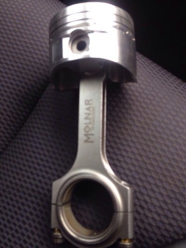

Postby fras » November 13th, 2015, 12:09 pm
TeamH2O
Posts: 8254
Re: ALL 4G93T OWNERS - Post your most common problems !!!
Postby TeamH2O » November 13th, 2015, 1:17 pm
saving up some cash for the molnar rods
currently at home porting out my head and should finish polishing by this evening.
