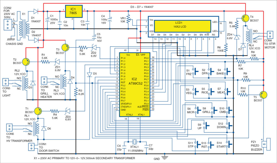

Postby adnj » April 8th, 2021, 6:00 am
It's more likely that your home had a short power outage near 12:00 that reset the digital clocks.
Digitally controlled ovens rely on an internal clock crystal to control the cooking cycle times.
Any microcontroller will require an adjacent clock circuit for operation.
In the example below, the clock (XTAL) is at the center of the bottom edge.

Postby teems1 » April 8th, 2021, 8:56 am
When power goes even momentarily, the numbers blink until someone sets it again.
My microwave even gives a message indicating to set the time.

Postby adnj » April 8th, 2021, 12:12 pm
teems1 wrote:Then the numbers would be blinking.
They were normal.
DMan7 wrote:Is obvious, electricity went at 11:40 PM so nobody noticed as they were asleep and then came back on very quickly resetting it back to it's default 12:00 hence the 20 minutes fast.
Not necessarily. There will likely be a decay time for the power supply circuit to the microcontroller that is great than any decay in the clock circuit. This is common.
If the power interruption is short enough, you may see this behavior.
