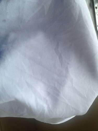

Took my maf sensor out and cleaned it just for argument sake....cloth remained clean....
