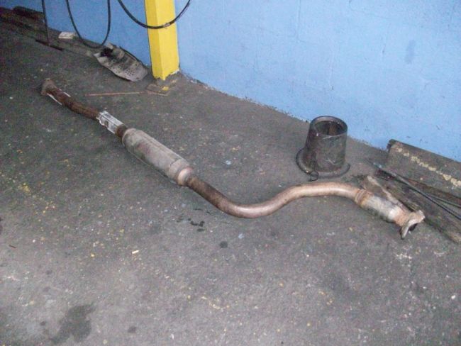

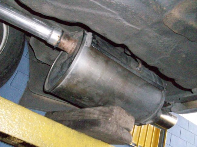

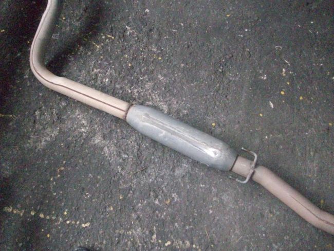

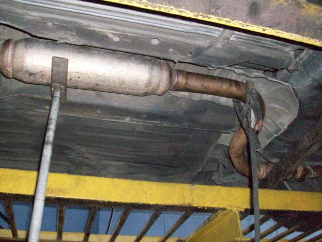

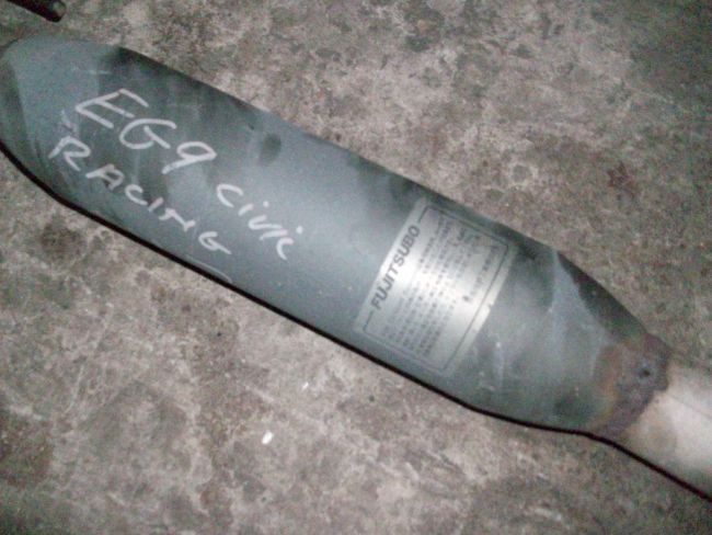

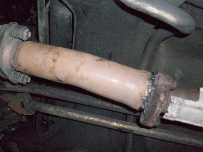

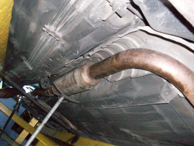

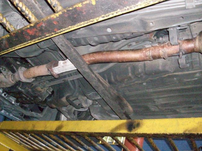

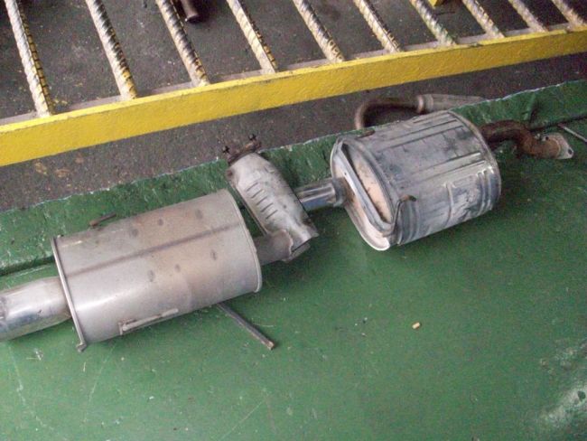

Old system with Fujitsubo center piping.

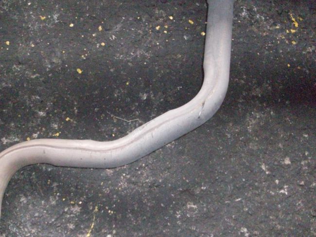

Crush bends 2.5-2":
The worse part of the piping:

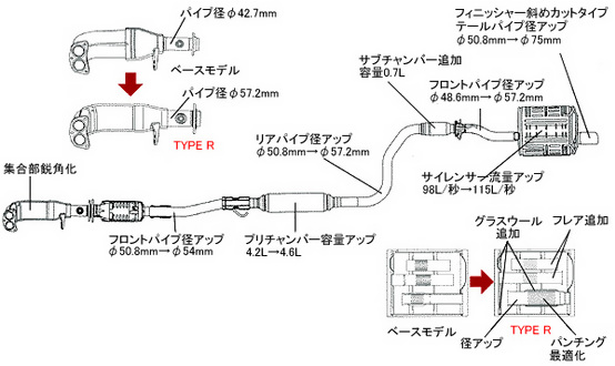

Civic type R vs Blitz
Civic Type R layout.

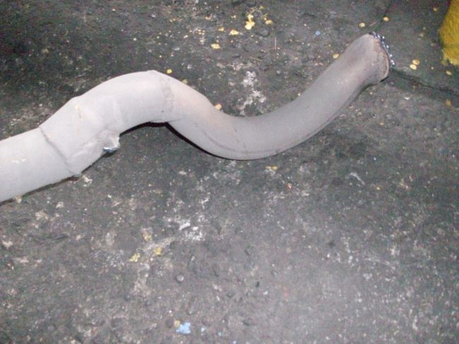

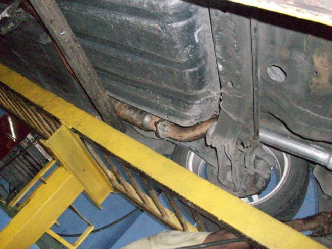

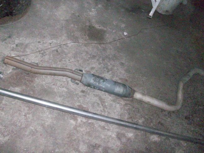

Actual piping:

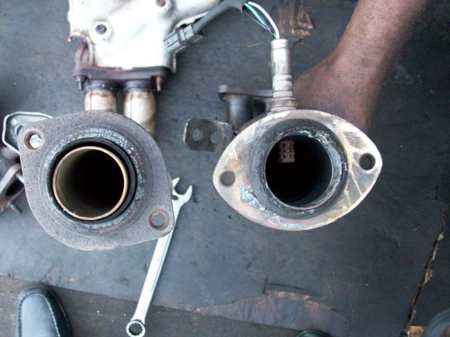

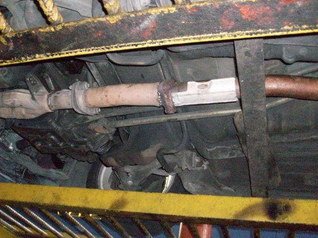

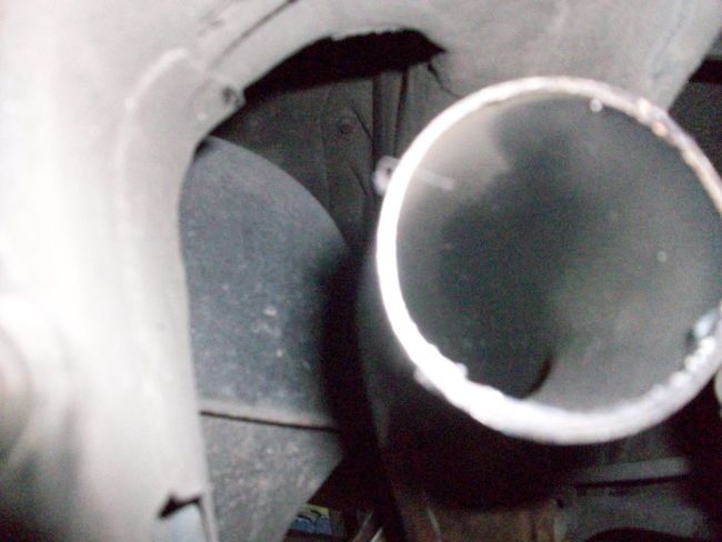

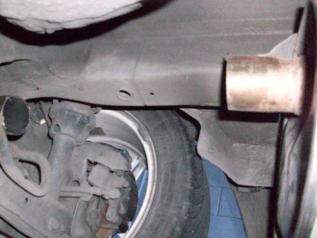

Had the cut the piping at the end to extend it, there was not much to extend. And the guy sleeved it to keep the flow.

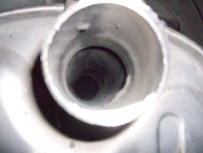

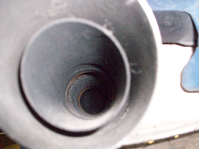

Here you can see inside the piping and barrel.

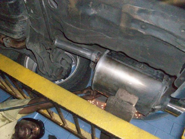

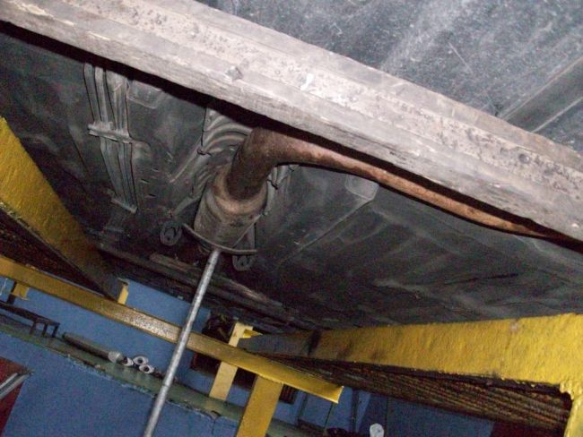

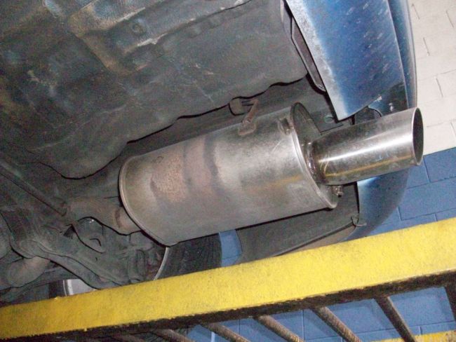

Now a look at the exhaust mocked up in place for the final touches. Just love those bends.
In the pic you can see the cat delete system we made from 2.5" piping, he also sleeved the piping to keep the flow smooth.
Conclusion:
The car feels better between 2000-6000 RPMs but doesn't put that hard to the red-line. It feels allot more responsive and the car is very quite and fun to drive.

red_dragon: I now noticed something, where we extended the piping to the rear the guy used a 2" pice of pipe, which is 50.8 but the entire system is 57.2. Is that going to make a big difference in flow? Would it be restrictive at that point?
red_dragon
Posts: 1257
Re: Exhaust upgrade.
Postby red_dragon » January 13th, 2011, 10:37 am
^ sorry as per STI7 .. I do not know what I talk bout .. you should as him

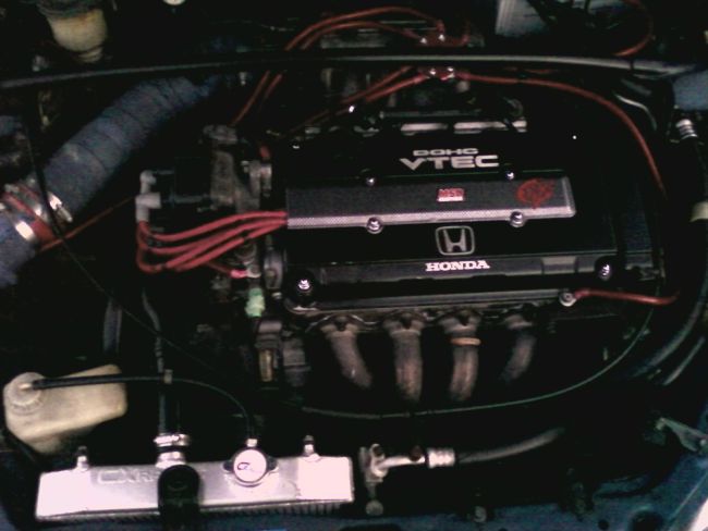

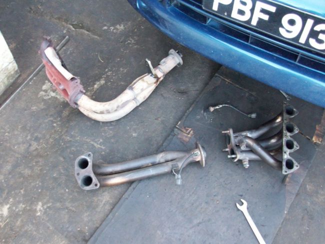

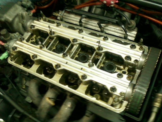

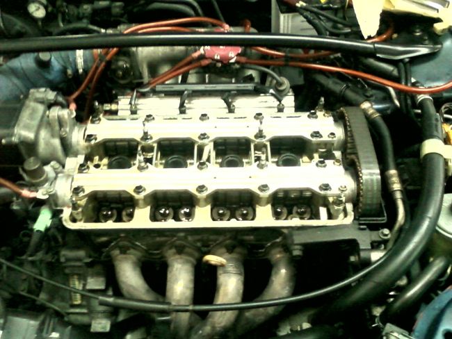

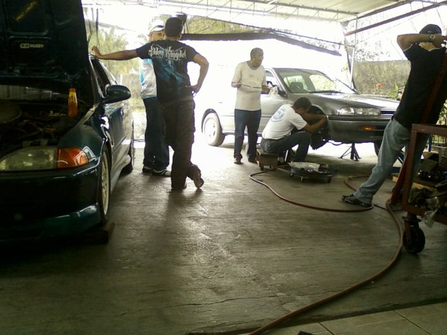

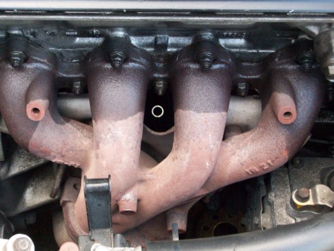

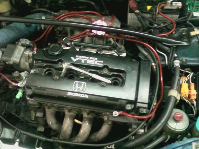

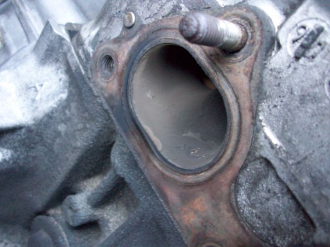

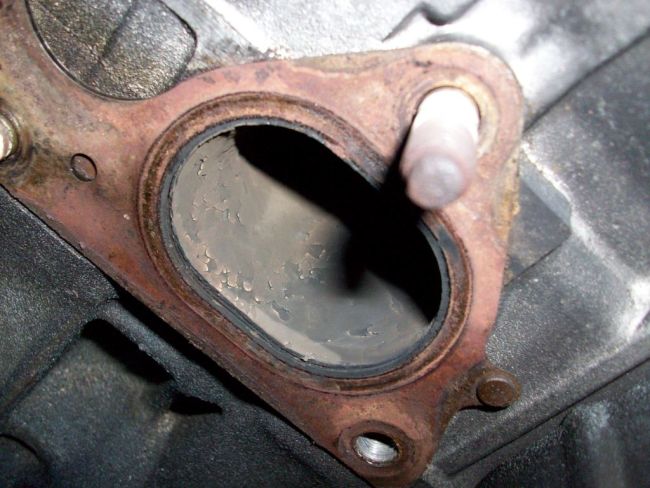

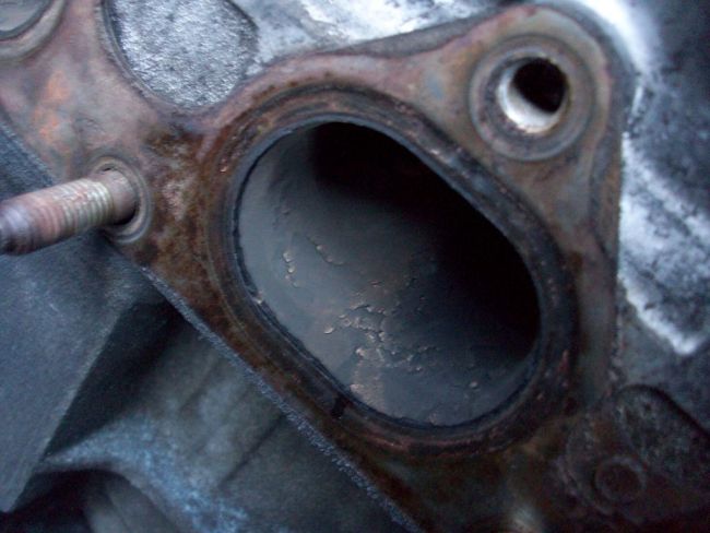

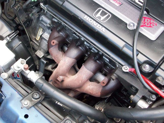

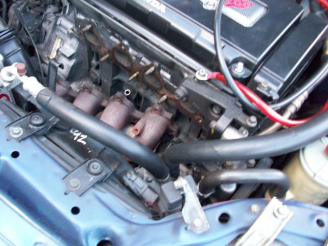

Installing the used JASMA headers.
Each cylinder, looking kinda gray.

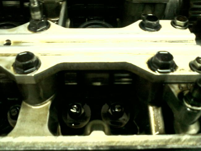

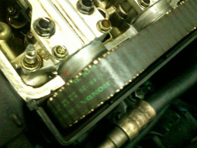

Adjusting the tappets by kazim.

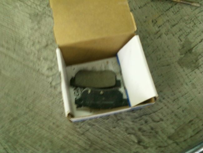

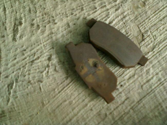

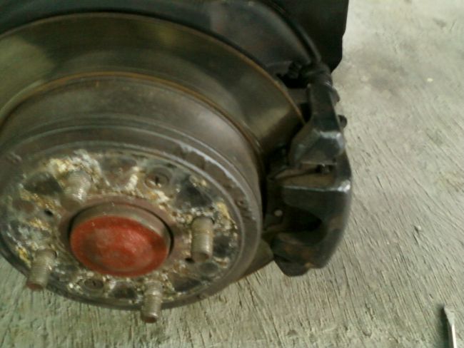

Installing new wagna rear brakes.
Old pads, dont know the brand but they were very new still. Lots of meat
Wagna

BTW next time u dyno
please post the AFR chart for the run
some other items to consider
condition of dizzy cap and rotor
base timing ..
TDC set correct
compression of motor....
plug wires
plugs
JDM_GUY
Posts: 1556
Re: Exhaust upgrade. Installed Headers&Brakes UPDATED*
Postby JDM_GUY » February 3rd, 2011, 1:02 pm
AF: 14: 2000-5000RPM
12-11: 5000-8000 RPM
Timing was check, Set to stock
TDC is good.
Cap is also good
Compression 180,180,180,180
New plugs
New plug wires
But after all of this I think I want to get into a Honda 600cc bike. Thats the ultimate.
