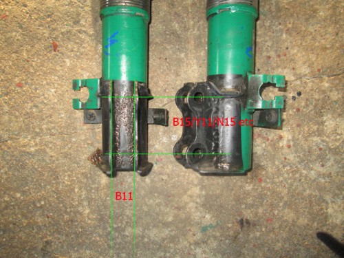

Postby d_sunnyboi » July 9th, 2013, 6:18 pm
i have a front pair of ''Z10 MODIFIED TEIN COILOVERS'' for sale....offer something for it!!...i had them on my car before i did the sr20 change over, they worked great for everyday use, not stiff but stiffer than stock shock absorber's! and wicked a$$ ride height...hear is what was done to them, the [b]shock head[/b] was replaced with ''B11'' and where it [b]bolted to the spindle was cut and replaced with bolt spacing B15/Y11/N16 etc[/b] but [b]at the width of the B11[/b] spindle!!!!
