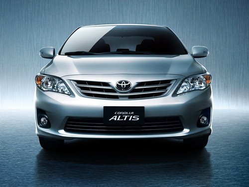

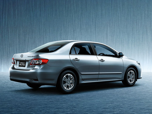

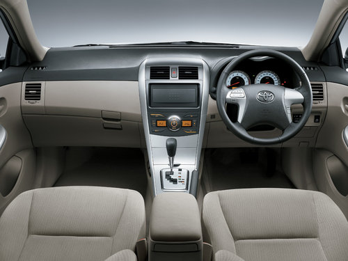

To note:
The current Singapore Altis is almost the exact look of our local Corolla, albeit with a 1600cc engine.
Toyota Models > Sedan - Small/Medium > Corolla Altis > Specifications
Corolla AltisWorld's Best-Selling Car
HighlightsGallerySpecificationsConfigurePrice
Technical Specifications
Corolla Altis 1.6
Transmission
Transmission Super ECT (Electronic Control Transaxle) 4-speed automatic
DIMENSIONS & WEIGHT
Overall length (mm) 4540
Overall width (mm) 1760
Overall height (mm) 1465
Wheelbase (mm) 2600
Tread - Front x Rear (mm) 1530 x 1535
Ground clearance (mm) 155
Kerb weight (kg) 1195 - 1255
Gross vehicle weight (kg) 1630
CHASSIS & SUSPENSION
Suspension - Front MacPherson strut
Suspension - Rear Torsion beam
Brakes - Front Ventilated disc
Brakes - Rear Solid disc
Tyres 195 / 65 R15
ENGINE
Engine Type 4-cylinders in-line, 16-valve DOHC with Dual VVT-i
Displacement (cc) 1598
Max. Output (kW (bhp) / rpm) 90 (122) / 6000
Max. Torque (Nm/rpm) 154 / 5200
Fuel tank capacity (Litres) 55
Fuel system Electronic Fuel Injection (EFI)
FEATURES
Headlamp Halogen
Rear window wiper Without
Intermittent wiper With
Side turn signal lamps Electric retractable
Rear sunshade (powered) Without
Wireless doorlock With
SAFETY
Anti-theft System With
Anto-lock Brake System (ABS) & EBD With
Vehicle Stability Control (VSC) Without
Traction Control (TRC) Without
Airbags Dual front
http://www.toyotasingapore.com.sg/cars/ ... /index.asp
