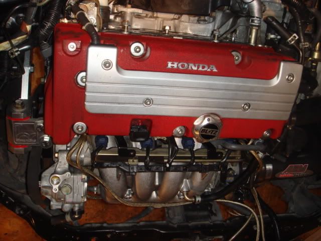

raymond if the cams were installed improperly the car would not have even started
the car was driving 3 weeks prior to you attempting to tune it
as for the specs on the cams... the duration and valve lift is 297 degrees and 12.4mm respectively
according to YOUR excuse... i am telling you they are NOT turbo cams, rsx cams or inferior to ITR cams
so considering the FACTS... dat YOU were swinging the car past redline.. YOU saw the spec sheet before purchase and approved it... YOU never changed or tried to determine the optimum vtec engagement point... and after 3HOURS ON THE DYNO, the car was still doin 201whp!
YOU are saying that I had the wrong cams and k20 engines KNOWN for breaking valves...
are you blatantly saying dat YOU were not responsible for my engine mashing up?
its a simple yes or no answer

297 degrees duration and 12.4mm lift :shock: That is stage 2 range cams.
Stock specs taken from Brian Crower's wesite
Stock 224° duration@.050 and 10.77mm lift (JDM K20A)
That is a lot of duration to be using the stock valvetrain....

sometimes if you dont have enough compression for wilder cams, you can actually loose power.
