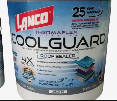

I see they have this ThermaFlex CoolGuard for TT$2,290 per 5 gallon pail - in white only

I am looking for a durable paint for the roof of a building. My pressure washer could do that from the ground. Pressure Washing a roof if not for amateurs, too much pressure would push out washers or raise any loose edges and cause leaks.

that white is pain but i guess thats why its 89% reflection but it looking like failure if this is all its doing
For commercial, residential, and mobile home roofs
Reduces interior temperatures up to 15°F
Provides waterproof seal
1 Celcius is 33.8 F
a 15 degree F drop kinda don't make sense? or i calculating wrong

Lanco® Coolguard™ Roof Sealer is a powerful, high performance roof sealer, made from a thick and single component acrylic urethane that is 100% elastomeric and will waterproof roofs and walls. It will provides a single monolithic layer that waterproofs and Insulates the surface. It significantly reduces the interior temperature of your house in two ways:
1. It will reflect 79% of all the sun rays, eliminating 89% of all the heat it received to the roof surface.
2. It uses Thermaflex Technology, a tiny insulating micro-spheres that increase drastically in size as the exterior temperature of the coating rises and prevents heat from being absorbed by the surface.

Duane 3NE 2NR wrote:I see they have this ThermaFlex CoolGuard for TT$2,290 per 5 gallon pail - in white only
do they actually honour that 25 yr warranty? if so that would save a lot of money in electricity bills since rates going to raise
is it that only white offers heat reduction?

for that warranty it would have a set of different conditions that you would never satisfy

Phone Surgeon wrote:that white is pain but i guess thats why its 89% reflection but it looking like failure if this is all its doing
1 Celcius is 33.8 F
Fahrenheit = (Celsius * 1.8 ) + 32.
Example...
100F = 37.7C
85F = 29.4C
So in this case a change in 15F = 8.3C
Posts: 17685
Re: What the Best Split level AC Units...Carrier LG, Panasonic?
Postby redmanjp » September 5th, 2023, 2:37 pm
a temp change of 8C is plenty! but that is probably maximum (up to 15F) and likely applies to extreme temps like 40C reducing to 32C. if the interior is like 33C inside i doubt it reducing to 25C as outside might be 28C even at night and u will have heat sources besides the roof.

If its 8 Celsius then yea its worth it.
