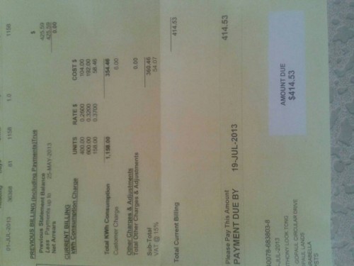

Today I checked the last bill we got, the 2nd pic I posted. From the calculation I made, our average daily kwh consumption for the last 2 months is about 51. From yesterday at 4:30 pm to today at 4:30 pm, around 50 kwh was consumed. So based on that, I in for another high bill next period.
The guy from T&TEC ruled out our refrigerator being a problem. He did whatever tests and said it was just fine. The only other thing we have that could possibly consume more electricity somehow is the water pump and window AC unit. That window unit a lil old, but always getting good servicing. Just last week or so it got serviced.
Anyone else know how much kwh a day they consume by chance?

Note my bill for this period
