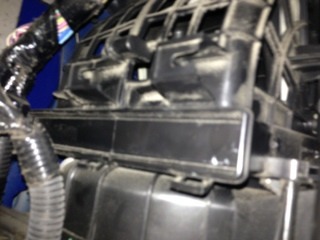

Postby gready123456 » February 24th, 2013, 12:04 pm
above the cylindrical part(blower motor) there is a rectangluar cover with some clips with a touch of white paint on each clip just use a flat blade screw driver to unfasten the clips your filter is behind that rectangular cover as i said before if u dont have a filter right now just vaccume clean the filter it works wonders.
good luck kenjo

Postby Kenjo » February 24th, 2013, 12:17 pm
This is how my truck looks so I am going to try it now and see,the cover looks a bit different though

Postby gready123456 » February 24th, 2013, 12:25 pm
it looks a bit diffrent but when this filter is clogged you can notice that the air comming from your ac vent is a bit lower than before making your ac a lott less efficent

Postby Kenjo » February 24th, 2013, 12:54 pm
Well it doesn't appear to be mobile and when I put my finger inside the grill above the rectangle I can feel that it has some fenestrations about 0.5 cm that seems to be hard plastic "filters' .i still put a toothbrush above in the grill and tried to at least remove some if the dust from the holes but luckily my a/c has never dipped and I was more concerned about the air quality,I also used a small compressor to try to circulate any dust in the system and I left the a/c on for a bit as well as sprayed some Lysol in there to circulate again to see if I could do anything about any germs/fungi hiding out in that nice area.thanks again for the help
