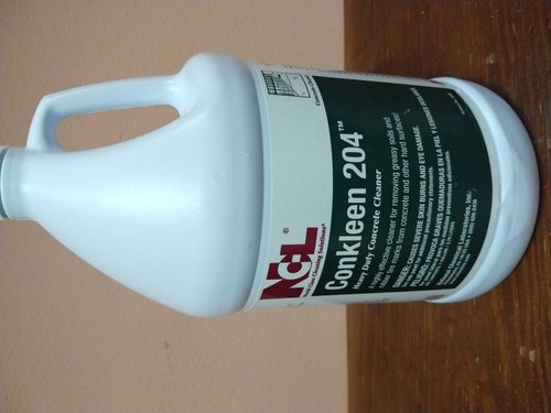

pugboy wrote:what type of chemical does the machine use ?
carluva wrote:Check out fb for a place called "clean it yuhself".
This guy rents you professional floor cleaning equipment and the chemicals and accessories needed. I cleaned the entire downstairs of my house (tiles) last year before Xmas and the tiles and grout were so clean after. Sounds like you may need machine assisted cleaning and the machine I rented will surely do the trick.
I was given this. It was diluted in a pump sprayer which was loaned as part of the rental as well. The chemical was safe for glazed porcelain tiles. It does irritate the skin and emit and odour which can become annoying after prolonged use. But just keep the place well ventilated when using and GTG.

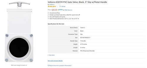

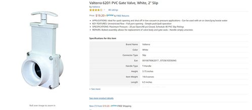

Anyone knows if these type of knife gate valves are available in Trinidad?
I am looking for 3 inch and 2 inch.
