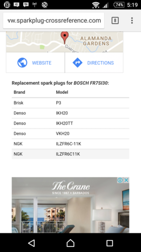

Re: CY lancer (08 lancer)
Postby rollingstock » January 20th, 2018, 7:17 pm
Where locally do you get the original Bosch spark plug for the 4a91 engine?
Or the replacement plugs started below?
