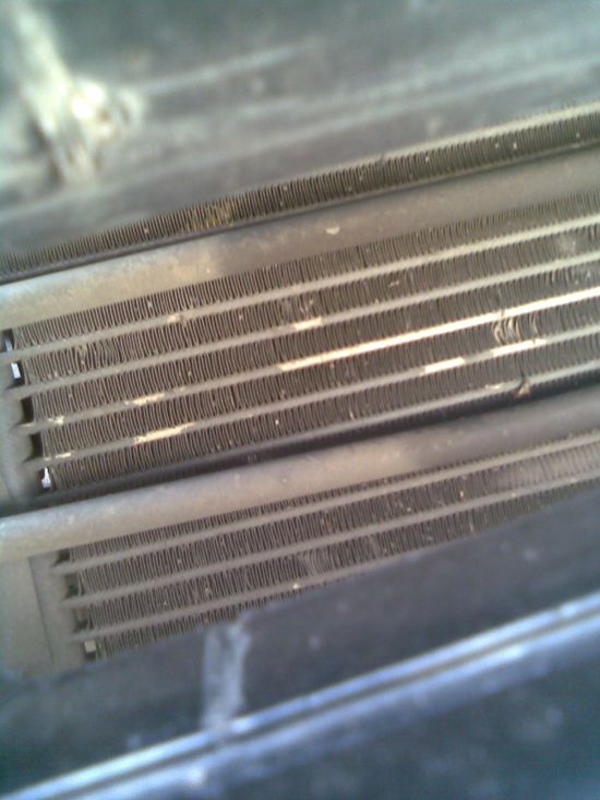

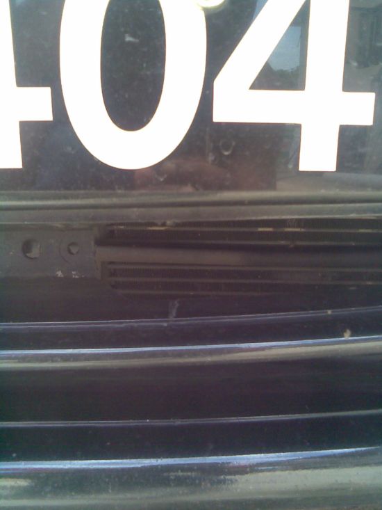

Postby Devon.Lopez » September 13th, 2009, 1:01 pm
I tryin to install the fan but some thing is directly on the condensor can somebody tell me what this is....by the way the car is a EG8 civic
This blocking the condensor so how i go put the fan on the front?
Can this be moved/removed? What is it
3stagevtec
Posts: 9622
Postby 3stagevtec » September 13th, 2009, 1:52 pm
it looks like chassis bracing.. what at the lines connected to?

Postby Devon.Lopez » September 15th, 2009, 8:53 am
I cannot see...It continuing down behind the bumper.
I might have to take the bumper off to find out :evil:
