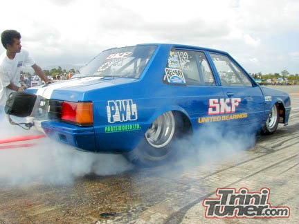

The
SKF lancer has steadily improved E.T. times over the years from 11.6 seconds
to a record best of 8.943 seconds @ 146.57mph. Granted the vehicle is
a record breaking machine in its own right, much of the credit must be
awarded to the driver. At the most recent drag event held in Wallerfield,
Ryan demonstrated to all, his supernatural driving abilities to which
he credits the Frank Hawley Racing School in Pomona, California. After
losing traction at the rear slicks, he was able to correct a 90 degree
broad-slide 3/4 way down the strip under high boost. Ryan claims he was
totally calm the entire time and was thankful to the Lord that he finally
got the car through the traps safely. Employing the pedal to the metal
technique, Ryan was able to successfully make the correction. If he were

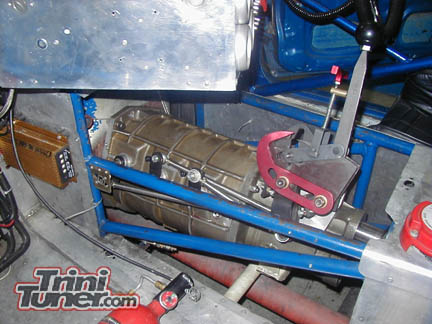

to simply back-off as an inexperienced driver might, his G-Force sequential
gearbox would have automatically neutralized thus causing the car to lose
total control.

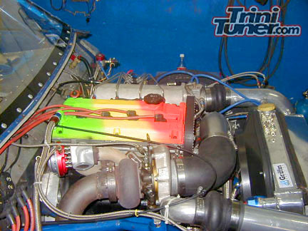

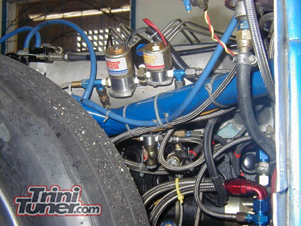

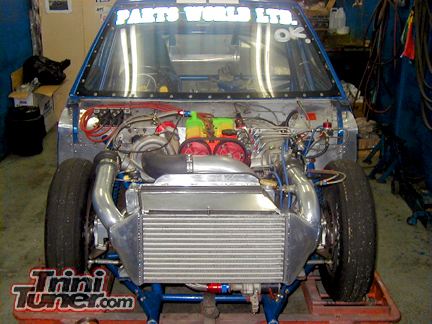

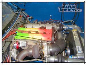

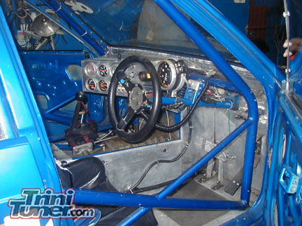

Engine
Specs:

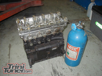

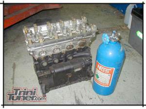

Mitsubishi
4G63 BT
2000cc DOHC 16 Valve
Head Ported
by Russ Engineering, Miami.
Head fitted with custom stainless steel valve
HKS 264degree Camshafts
AEM Vernier Gears
Block overbored
0.030" (85 mm bore)
J.E. Forged Pistons 0.030" over
Total Seal Rings (chrome face top rings)
Crower Connecting Rods & Bolts
Stock Crank Shaft
ARP Head Studs
ARP Crank Studs
Balance Shafts Removed
Stock Oil Pump
Max RPM 8,500

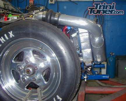

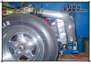

Turbonetics
T6 6 Turbo ( Secret Specs)
Rear End, Ford 9" 4.8 ratio
XS Engineering Intercooler
Turbonetics Race Gate
Mc Cloud Clutch, 10" adjustable single disc
Island Empire Aluminum Drive-Shaft
Rear Slicks - 31 x 14 -15
Front tyres - 4.5 x 24.5 -15

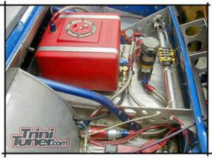

Weldon Fuel Pump
SX Filters
SX Fuel Pressure Regulator
Harwood Fuel Cell
Engine
Management:

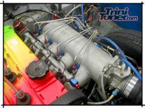

SDS (Simple
Digital System) by Racetech in Canada

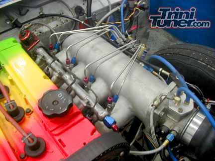

Model- EM-2 Fuel Management
Oxygen
Sensor (not used)
4 x 930cc. R.C. Engineering Injectors
Hall Sensor Magnet crank trigger.
Fuel and Ignition handled by ECU (adjusted by hand held programmer)
Crane HI-6DI2 Ignition with optional manual retard for nos.
Moroso 11mm Ignition Wires
NGK R6254E-9 Plugs
C16 Fuel
