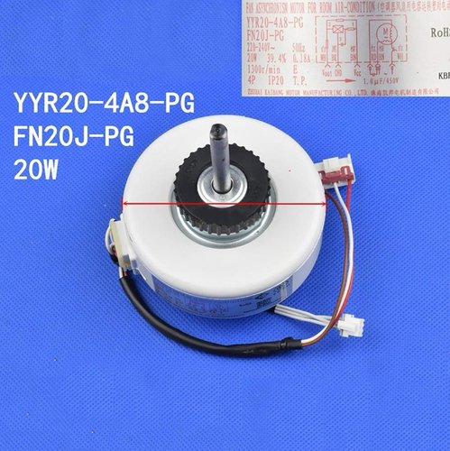

Anyone know where I can get one of these motors? It’s from a 12k daikin
(Motor seems to be from here units too)
Tried a 27w motor but didn’t work
Peaks, maraj nor general in south have

Lemme guess, stator toast?

Well you help me out. I went and get the coil sensor,
It came me with ambient sensor on the same jack but I had to re-use my original room sensor to get the unit to cycle.
So some madness went on where both motor and coil sens crap Itself..
Ac give me more headache than ice machine and walk ins yes
